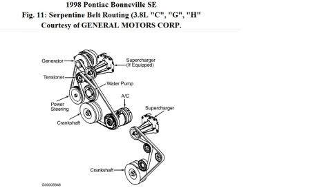

By belt broke how do I put the new belt on (diagram)
Monday, August 30th, 2010 AT 3:02 PM
JDL
MECHANIC
16,098 POSTS
Usually there is a belt decal under the hood. In the picture, notice the info at the top. Bonneville SE--3.8 L engine, vin H.
