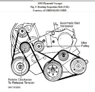

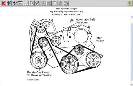

diagram and how to put on a serpintine belt routing for 1995 plymouth voyager 3.0

Here it is.....

See below
