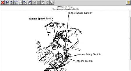

Where is the speed sensor located. Could you please point it out on a diagram, if possible Thanks John

Output Speed Sensor On transaxle, facing front of vehicle. See Fig. 6
