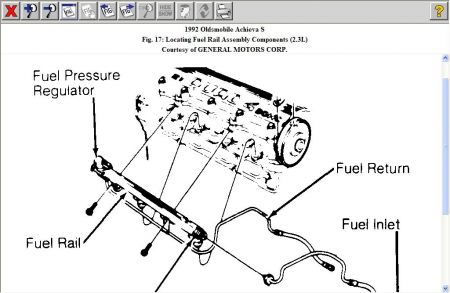

Also could you tell me where the fuel pressure regulator is
Jul 29, 2008 at 2:07 PM
  • CAR REPAIR CONTRIBUTOR
  • 75,992 POSTS
The CEL is very critical-take it to autozone they will read it free for you and comeback with the OBD1 code/s this is our starting point in order to troubleshoot this problem- The pressure regulator-see below

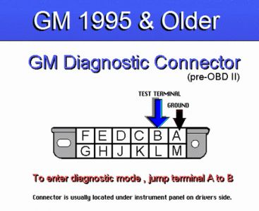

Do you have this under the dash-if so jumper A to B and read off the flashes
https://images.2carpros.com/forum/automotive_pictures/12900_GM_ALCL_7.jpg
Jul 30, 2008 at 12:07 PM
SNPR1992
  • 10 POSTS
flashed once then a short pause then it blinked twice.

There's no stored code/s in the computer otherwise it will give after DTC 12
