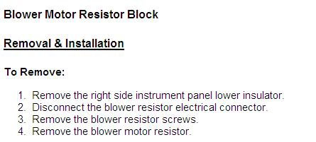

About a month ago my fan stopped working unless it is on the highest setting, which is really loud and very strong. I've looked in my manual but can't find anything about this.

Hello, my first thought is the resistor assembly. High speed doesn't use a resistor.
