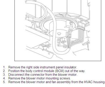

How to replace the blower motor and can it be done by a novice mech such as myself

Welcome to the forum, my info shows this. Goodluck
