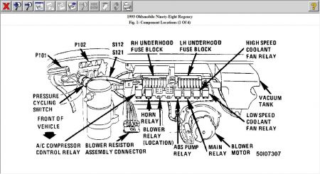

1993 olds 98 blower doesn't work at any speed. Fuses good, 1.5 volts at blower connector. Where is the relay located?

Blower motor relay is located on engine compartment relay center, on right side of firewall.

See below and Good Luck
