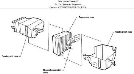

I would like to know where is the expansion valve located please help

The expansion valve is attached to the cooling coil (evaporator ) in housing under the glovebox.
