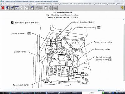

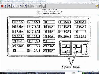

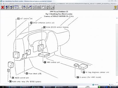

My cigarette lighter is not working. Where is the fuse so I can check it?
Friday, December 28th, 2007 AT 7:10 PM
MERLIN2021
MECHANIC
17,250 POSTS
It's fuse #13 15 amp located as follows...
