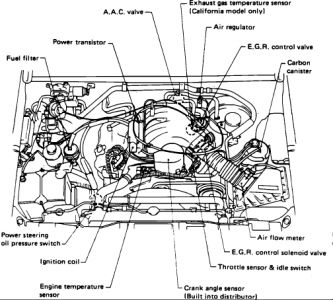

Where is the control module located on the 1991 Nissan Pathfinder?

If you're talking about the ignition control module its also CALLED
POWER TRANSISTOR
Located on the R.H. side of the intake plenum, near the ignition coil.
SEE BELOW
