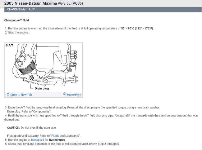

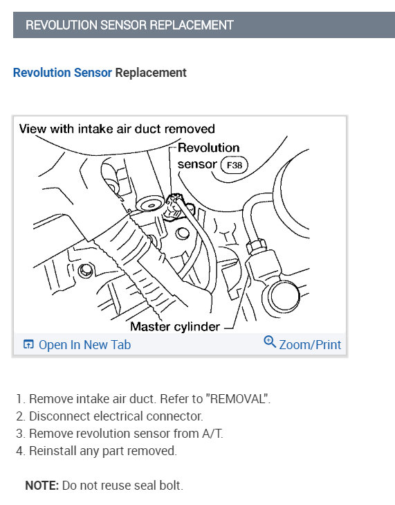

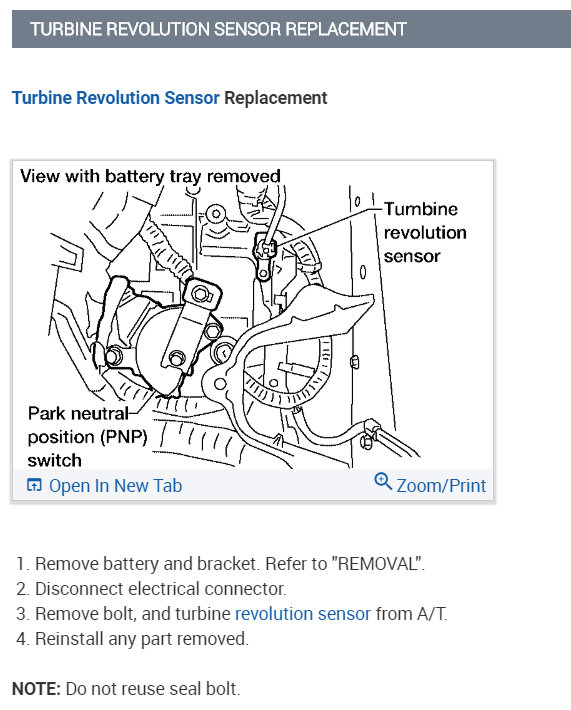

When warm the shift from d1 to d2 "catches", (lurches?). Also, after a few miles of warm up, the shift from park to R or to D is met with a pause, and then a lurch. Very severe when shift to D.
There are no DTC's
Jun 6, 2020 at 6:25 AM
  • CAR REPAIR CONTRIBUTOR
  • 54,350 POSTS
The first thing is to check the transmission fluid level. If okay I would change out the input shaft sensor. here is how in the diagrams below:
Fluid Types
Recommended fluid .................... Nissan Matic "K"
NOTE:Using Automatic Transmission fluid other than Genuine Nissan Matic K ATF will cause deterioration in driveability and automatic transmission durability, and may damage the automatic transmission, which is not covered by the NISSAN new vehicle limited warranty.
Capacities
Fluid Capacity .................... 7.3 L (7 3/4 US qt. 6 3/8 Imp qt)
Jun 6, 2020 at 11:32 AM
