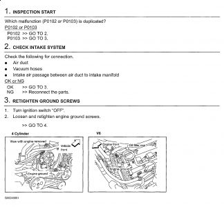

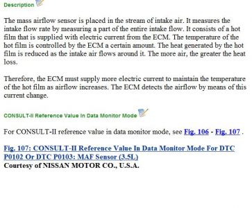

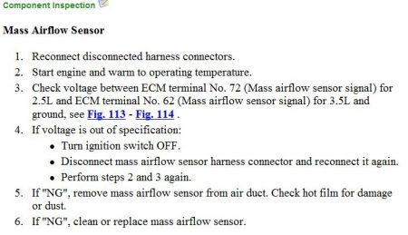

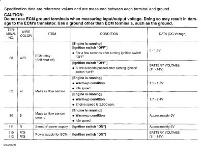

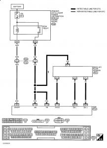

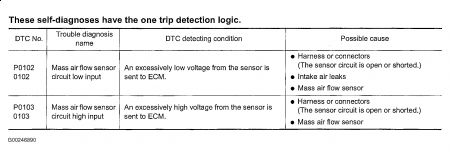

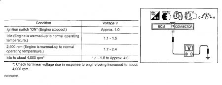

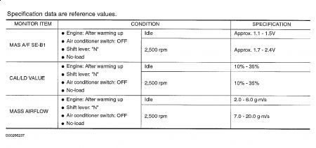

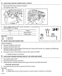

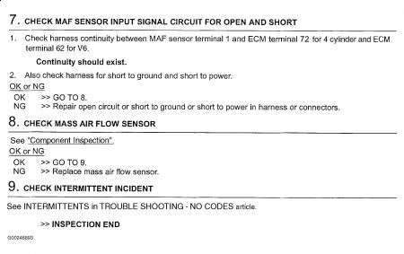

P0102 deals with the sensor circuit. I am not convinced that the car wash did this. The reason being that the sensor and harness is located at the top of the engine, the water could not have gotten to them. Here is the diagnostic for P0103.
https://images.2carpros.com/forum/automotive_pictures/55316_03altimap0103desc1_1.jpg
https://images.2carpros.com/forum/automotive_pictures/55316_03altimap0103_1.jpg
https://images.2carpros.com/forum/automotive_pictures/55316_03altimap01032_1.jpg
https://images.2carpros.com/forum/automotive_pictures/55316_03altimap0103fig98_1.jpg
https://images.2carpros.com/forum/automotive_pictures/55316_03altimap0103fig100_1.jpg
https://images.2carpros.com/forum/automotive_pictures/55316_03altimap0103diag1_1.jpg
https://images.2carpros.com/forum/automotive_pictures/55316_03altimap0103diag2_1.jpg
https://images.2carpros.com/forum/automotive_pictures/55316_03altimap0103diag3_1.jpg
https://images.2carpros.com/forum/automotive_pictures/55316_03altimap0103desc3_1.jpg
https://images.2carpros.com/forum/automotive_pictures/55316_03altimap0103fig114_1.jpg
