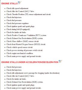

The car was running fine no problems. We didn't use the car for one month then when I went to start, it run out of gas. After refueling it didn't start. Upon checking the spark plugs I saw lots of oil around them-Replaced head gasket,spak plugs and wires, new fuel filter. Now it starts when the engine is cold but if I push the gas it stalls. If a let it run without giving gas it will stall after a minute or two. It seems like it's not getting gas or chocke or enough spark?

A fuel pressure test will confirm or exclude the fuel delivery aspect.
https://images.2carpros.com/forum/automotive_pictures/30961_nis1_2.jpg
MAke sure that all of your vacuum hoses are hooked back up and not leaking. Did you have the head machined?
