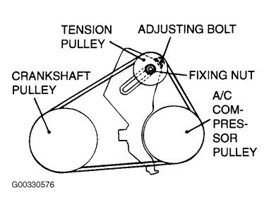

How do I adjust the tension on the AC belt of a '04 Montero Sport

Loosen fixing nut trun adjuster bolt till tight ,tighten fixing nut.
