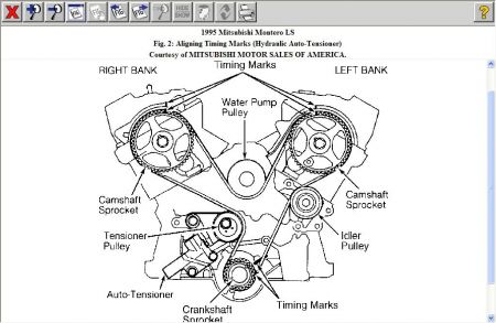

I lost timing marks alignment when changin timing belt,
can some one send some procedures on how to align timing marks?

Put the engine's no.1 piston on its compression stroke/TDC both valves should be closed. See below
