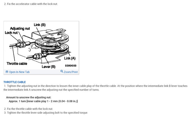

Hi this is my mothers car, since she bought it she has a problem with the idle speed. i have changed the clutch, air flow sensor, throttle body, idle control valve, air recirculation valve, the only thing i haven't changed is the ecu!!! is there anything else i could be missing?????

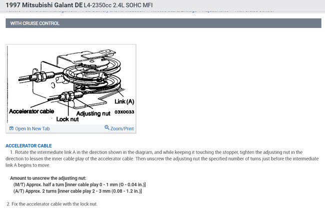

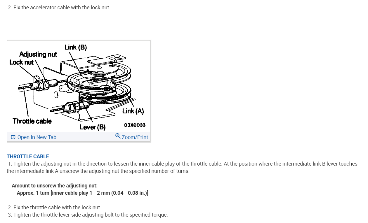

It sounds like the throttle cable needs to be adjusted, here is a guide to help and instructions below for the adjustment.
https://www.2carpros.com/articles/engine-idles-too-high
Check out the images (Below). Please let us know how it goes
