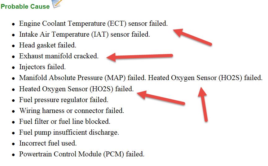

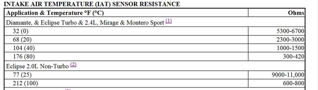

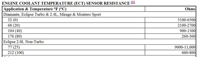

check fuel pressure with a gauge first. see pic for causes it may be temp sensor or anO2 sensor if you got a bosch one those are not very good also check for an air leak through duct work leading to throttle then check sensors with chart I'm sending.

KRYPTECLIPSE
  • 45 POSTS
Thank you very much. This really helped a lot. What turned out to be was the brake booster vacuum hose. Replaced and car is running smooth again. Tiny vibration on steering wheel but it is not failing out on me. If you got any idea what that might be let me know. Thanks again
