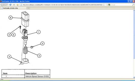

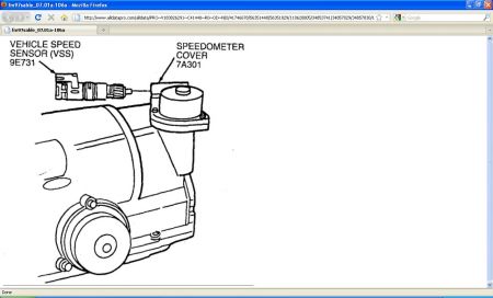

Transmission problem
1997 Mercury Sable 6 cyl Front Wheel Drive Automatic
cant found the location of speed sensor

i posted two different diagram's because there are two different transmission option's for your car.But i listed both of them.Also check the gear that attaches to the sensor for being worn or broken.
