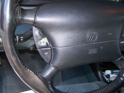

Please advise how to change the steering wheel mounted cruise control switches.[img:480deda3f4]http://www.2carpros.com/forum/automotive_pictures/568865_100_3794_1.jpg[/img:480deda3f4]

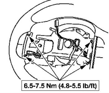

Disconnect the negative battery cable and wait 5 minutes, then from behind the steering wheel remove the screws that attach the air bag to the wheel, then remove the screws that attach the switches to the wheel. Unplug connectors and you are done...
