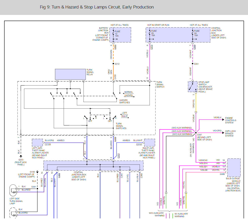

Turn signals do not work or blink or click. Bulbs replaced, fuse replaced, flasher, and turn signal switch. The hazard lights work. My high beams come on when I pull the switch towards me until I release it, as it should. But when I push the lever and it clicks in place the high beams do not come or stay on as they should. The indication light on the dashboard does not come on either. I'm guessing these two are linked

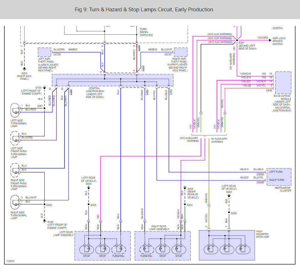

It looks like you have lost power going to the system, here is a wiring diagram and a guide that will help you see what the problem is.
Please let us know what happens so it will help others.

Check your flasher first Flasher is located on the signal light switch, at the rear next to lever, remove lower column cover and on the signal switch next to the lever you will see flasher plugs right into switch.

The turn signals and brake lights won't work. I have checked the bulbs and the fuses under dash. The third brake light in rear windo does work. All other electrical seems to be fine. Any ideas.

The brake lights go through the turn signals, since the 3rd light works, im gonna say that you have a bad turn signal switch

Went to junk yard and pulled one from 96 T-Bird. Works fine. Thanks

Suspect faulty electronic flasher unit, located behind dash to the left of the steering column

Check the Turn Signal Relay On top of steering column.

Suspect faulty multifunction switch. This is the switch used to operate the signals, wipers etc.
