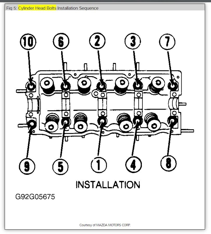

what is the torque pounds for the cylinder head

68 ft lbs of torque.

Great addition to this thread! Please feel free to help out whenever you are on the site :)
Image (Click to make bigger)
