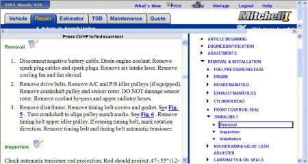

I has problem water pump .so i went midasauto check my car .they say you need replase water pump.and they chaegemore then $750. Do you know how can I do.please help me.
May 23, 2008 at 1:38 PM
  • CAR REPAIR CONTRIBUTOR
  • 75,992 POSTS
You need to remove the timing belt to get to the water pump and a repair manual -see below
