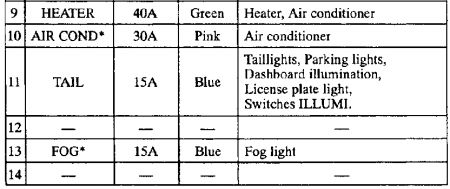

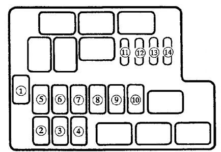

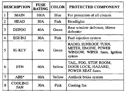

I have a 97 626 that will not start after the alternator seized, the car was running fine till now, the new alternator is installed and every thing works but we have no fuel pump activation, all fuses are good, the fuel pump runs when jumped at the data link and we have injector activation at crank, everything else works on the car just not activating the fuel pump

Have you checked the fuel pump relay? it's under the hood in the fuse box, also check the in car fuse "K"

the relay works if you jump it at the data link box and the pump runs but when you turn the key to crank the relay and pump stop working, we have power every were else including at injectors just no fuel pump

OK thats the test lead for the pump? The relay still needs to be checked, powers with the key...

yes we have power to two of the four terminals at the fuse box with the relay out when we turn the key on
