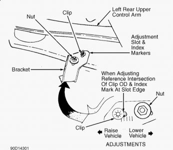

1997 Lincoln Town Car
how can i get the lincoln leveled the airshocks got it sitting high up how do i get it normal?
