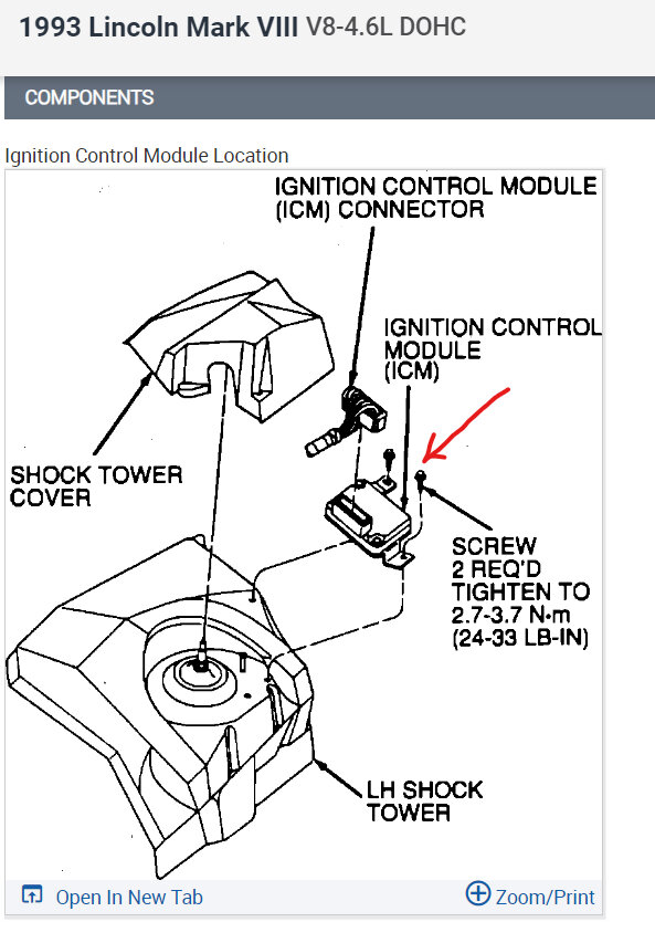

i have 1993 lincoln mark viii, the car cannot start, i did change fuel pressure regulator and also crank sensor but the car still cannot start, every time i try to start the car you can smell a raw fuel from tailpipe.what can i do to make my car run ?

sounds like you don't have any spark. check for spark?

Yep, I agree with LEGITIMATE007, you don't have spark, It is common for the ignition control module to go out in these cars, here is a video to help confirm the no spark issue.
https://youtu.be/baq_aEWNQ0Y?si=1NW2lcSAIEGC9D1O
Here is the location of the ignition module so you can swap it out. Check out the images (below). Please let us know what happens.
