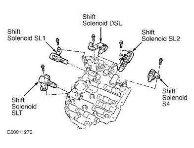

hi
my problem is that my transmission is not shifting right
and the check engine light is coming on all the time
i checked it with the obd II and the code P0750 came up
witch is solenoid valve A ,but there are 5 solenoids ,i called the dealer but they said they don't know witch one is . they gave me this numbers for each one (35290A,35210,35240,35220,35230) and i have to decide witch one to order but i want to be sure i order the right one,,if somebody can help me with this, i really appreciate it because i have my car park for a couple of months .any website or company let me know please
thanks a lot
leo

Hello .. thanks for the donation .. much appreciated P0750 Shift Solenoid SL1 SHIFT SOLENOIDS SL1, SL2 & S4 NOTE:The following information can also be used to diagnose DTCs P0750, P0755 and P0765. For testing of shift solenoid SLT, see DTC P1760: SHIFT SOLENOID SLT under DIAGNOSTIC TESTS. Raise and support vehicle. Remove transaxle oil pan. Remove shift solenoid(s). See Fig. 3 . Using a DVOM, measure resistance between shift solenoid SL1 and SL2 terminals. On shift solenoid S4, measure resistance between ground and solenoid terminal. On shift solenoids SL1 and SL2, resistance should be 5.1-5.5 ohms. On shift solenoid S4, resistance should be 11-15 ohms. On all solenoids, if resistance is not as specified, replace solenoid. To check shift solenoids SL1 and SL2 operation, connect positive lead with 23-watt bulb from battery to terminal No. 1 (White wire on shift solenoid SL1, or Yellow wire on shift solenoid SL2) of solenoid. Connect negative lead to terminal No. 2 of solenoid. With power supplied to solenoid, ensure solenoid valve moves outward. With power disconnected, ensure solenoid valve moves inward. Replace solenoid if operating sound cannot be heard. If solenoid operates, diagnose valve body malfunction. To check shift solenoid S4 operation, connect positive lead with 23-watt bulb from battery to solenoid terminal. Connect negative lead to solenoid body. With power supplied to solenoid, ensure solenoid valve moves outward. With power disconnected, ensure solenoid valve moves inward. Replace solenoid if operating sound cannot be heard. If solenoid operates, diagnose valve body malfunction.
https://images.2carpros.com/forum/automotive_pictures/266999_sol_3.jpg
Hope this helps
https://images.2carpros.com/forum/automotive_pictures/266999_AAA2_1165.png
