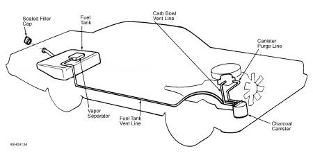

How do I install a charcoal canister
Saturday, April 24th, 2010 AT 7:35 PM
MHPAUTOS
MECHANIC
31,937 POSTS
Hi there,
Mark the 3 vapor lines so as not to mix them up and remove them, undo the retainer that holds the canister in place and remove, re fit new canister and attach th 3 vapor lines to the correct ports.
