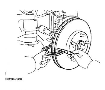

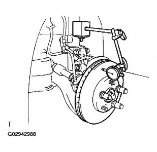

How do I know if my brake rotors should be replaced or the rotors resurfaced?
May 11, 2010 at 3:38 PM
BLUELIGHTNIN6
  • CAR REPAIR CONTRIBUTOR
  • 16,542 POSTS
you will need to measure the brake rotor runout and thickness. if it is not within specs then you should replace the rotor(s). disc runout should be no more than 0.05 mm and thickness should be between 26mm and 28mm
