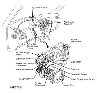

Where is it located I looked at the blower motor but couldnot identify it and can I replace myself.
Friday, June 26th, 2009 AT 4:03 PM
BLUELIGHTNIN6
MECHANIC
16,542 POSTS
The blower motor resistor is located behind the right side of dash, on the evaporator case.
If you have some mechanical experience than you should be able to replace the resistor without too much trouble.
