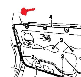

hi i have a w reg freelanderwith a broken passenger side mirror, i have bought both the replacement glass and mirror casing, but dont know hoe to take off hte bits of old cracked glass as some of it is smashed off, or how to attach the casing. hope you can help.
many thanks for your time.
emma. xx

remove inner door trim and the plastic panel (arrowed) unclips from door .. the bolts for the mirror are behind this panel !
https://images.2carpros.com/forum/automotive_pictures/266999_land_28.jpg
