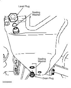

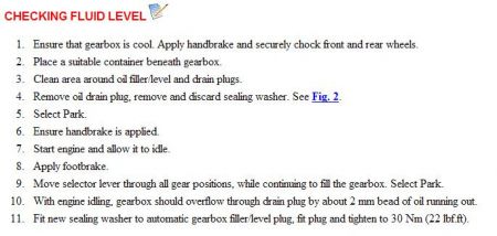

Transmission is slipping when it is first put into gear.
Where do you check the transmission fluid?
Tuesday, September 1st, 2009 AT 8:55 PM
BLUELIGHTNIN6
MECHANIC
16,542 POSTS
FIG. 2
