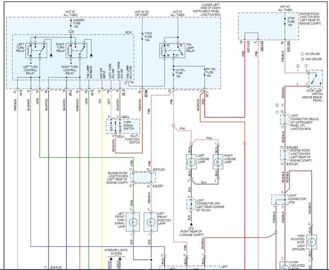

I bought a used car recently and have noticed that neither of the front parking lights come on when I rotate the switch on the stalk to the first detent. It seems strange that both bulbs would be burned out at the same time, but not an impossibility. Going to check the fuses first, but I don't believe there is a fuse just dedicated to the parking lights. The bulbs are difficult to remove. I don't know if I can do it. Is there any known wiring issue associated with this or has anybody out there encountered this before.

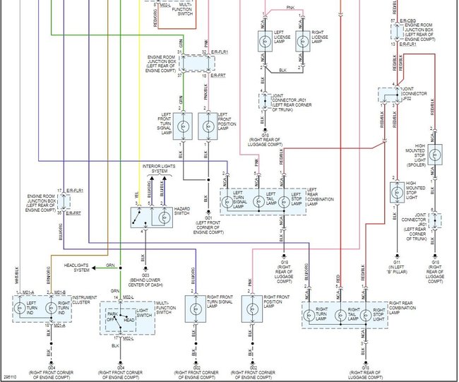

Do the taillights and dash illumination light comes on when the lights are turned on?
I looks like the running lights are power by the same fuse
Read the guide below on using a test light, best way to check fuses and for power
The wiring diagrams for you exterior lights are attached below

Could be, I would start by checking the fuses then the bulbs, also you should know that, the way vehicles are made now, is that several components will be on the same ground, therefore, if one thing goes bad*shortsout) then everything on that ground will or could be affected, causing them not to work either, this is mostly in the electronics of the vehicle, so use that info when checking on these items

Check for a bad ground. Chances are power is back feeding into that circuit.

Check the wiring around the lights.
