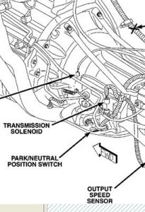

Where is the Neutral Safety switch located on my 2004 Jeep Grand Cherokee?

The park/neutral switch is located on lower left side of transmission-
