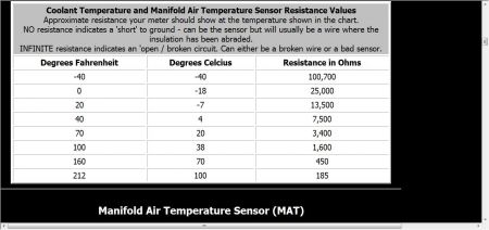

Take the reading before you start the vehicle and when the engine is fully warmed up. Use a high impedance volt-ohmmeter. Resistance should be less than 1000 ohms with a WARM engine (examples = 212* would be about 185 ohms, 160* would be about 450 ohms, 100* (not warm enough) would be 1,600 ohms).

Alright so a friend tested it using your chart and the numbers are bit off, looks like it's not putting out enough resistance.
What is the procedure for replacing it? Do I just crank it out and replace it with another? Do I need to do something to make sure I don't get air in the system?

Just remove it and make sure it doesn't leak
