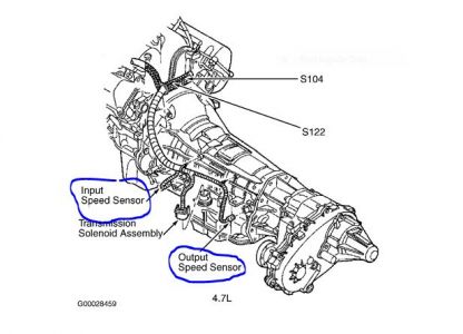

Last week my check engine light came on. now my transmission does not shift right from 1st to 2nd gear. I did a diagnostic and it came back with an error code of p0720. The error points back to a transmission speed control sensor. I purchased a sensor ( MFG# S41015) but cannot locate where it goes on my transmission. All the diagrams that I have looked at do not resemble my transmission what so ever. Did jeep use different types of transmissions? is there a simple fix to clear the code and get my jeep running right?

Hi there,
Which model Cherokee do you have?

Its a 99 Jeep rand Cherokee. I tried to find some info on wat type of engne an transmission but have no luck. I have bee to caning the sensor is easier thanchanging a tire. At last I know where to find the tires. Any info will help greatly. Ihave bookmake your ste because I am sure I will be back.

Is this a help?
https://images.2carpros.com/forum/automotive_pictures/61395_Capture_9.jpg

problem solved! I purchased the output speed sensor from a jeep dealership part #4800879, Mopar. The part cost 23.30 plus tax. It took me about 10 minute to install without any special tools. I kept the battery disconnected for about 20 mintes to clear any codes. the check engine light is gone and the jeep shifts like it was brand new. I might go ahead and replace the input sensor to see if gas mileage improves even more. Thanks for the assist and please pass the info on.
