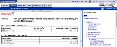

I have a 1993 jeep cherokee sport 4.0 liter. wont start. replace the crank position sensor still wont start.?
checked the fuel pump pressure,it was 75 psi. checked all fuses, all ok. checked relays all ok. sprayed some starting fluid in throttle body and tried to start jeep and it seem want to kick over a little bit, but it just cranks over with and nothing just turn's over. Ran a code check the jeep by turning off the key and turning on and turing off then turning it back on. codes i got was 12,42,24,23,11,55. My jeep was running that day and went to start it and all it did was just crank over. checked the spark plug and it was dry. can you help me solve this problem? Thank you.
