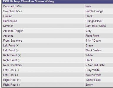

Where does the speakers plug into the main harness (the location of the harness)
Saturday, November 28th, 2009 AT 8:28 PM
JDL
MECHANIC
16,098 POSTS
Hi, thanks for the donation. My wiring info on our model year is limited, this is all I could find. Found that at the12volt.com
