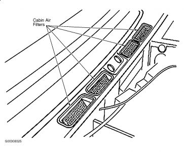

What can I do about mold smell in the air conditioning
system of my car? Where is the air conditioning filter
located and is it easy to get too?

CABIN AIR FILTERS Removal & Installation (1998-2003) The air particle filter system (if fitted) is located in the plenum below the windshield. See Fig. 1 . The filter elements are retained by adhesive strips which are attached to the filter molding. The filter is fitted with the light flocked surface facing towards the engine. Removal and installation procedures are not available from the manufacturer. Fig. 1: Locating Air Particle Filter System
