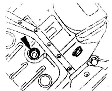

Carefully remove the drain plug and drain the transmission fluid.
https://images.2carpros.com/forum/automotive_pictures/248015_t2_1.gif
Refit the drain plug and tighten to the specified torque figure. Use a new 0-ring. INSTALLATION

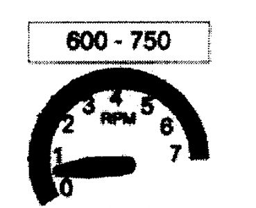

NOTE: Ensure that the TCM is connected and functioning correctly. Select Park and start the engine.
https://images.2carpros.com/forum/automotive_pictures/248015_t6_1.gif
Cycle the gear selector. From P to D. From D to R. From R to P. From below. Adjust the transmission fluid level.
