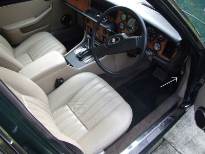

PRINCEOFDARKNISS
did u check the interia cut of swich?
if may be bad or going bad
Nov 17, 2008 at 9:36 AM
PRINCEOFDARKNISS
IF your jag has it, it
https://images.2carpros.com/forum/automotive_pictures/271868_Xj6_1.jpg
should be in the spot marked
Nov 17, 2008 at 9:50 AM
BENTLEY EVERSLEY
  • 31 POSTS
Hi there Princeofdarkniss, Thanks for the info. I did check the Interia Switch several times by pushing it up and down,fleaving it in the up position. Would you know how I can go about bypassing it? By the way I love meeting other Jaguar owners.

The enertia switch should be pushed "down" to be reset. Don't forget about the CPS.
