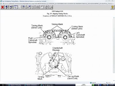

i have a 95 infiniti g20, manual 5 speed, 4 cyl. 2.0
twin cam, i recently replaced the head gasket and now i have difficulty putting the timing chain back on.. i don't know where the alignment marks are..
can someone please post a diagram or a link to one

Presto! Make sure you set it right before you take the old one off, this engine can be damaged by rotating the crank without the chain....unless the heads are off!
https://images.2carpros.com/forum/automotive_pictures/62217_G20_TimingMarks_1.jpg
https://images.2carpros.com/forum/automotive_pictures/62217_30961_mitchell_2_62.jpg

thanks..do you how to find Top dead center on the #1 piston?

If you need to ask this one leave the engine repair to a pro...If you don't do it right you may as well buy a new one...I do not know were in the process you are!If you line up the marks as I said, BEFORE the chain comes off....You will be at TDC...
