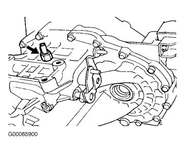

My reversing lights are not working. We checked for fuses but cannot find a fuse that is for the reversing lights and have been told there is a switch. Can you please tell us where to find this switch? thanks

Hi there, The switch is on top of the trans axle see pic. The fuse should be in position No 5 in the fuse box. Mark (mhpautos)
