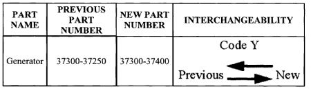

Hello - Well, I wouldn't say you are the unluckiest person........at least they are free each time.... Now, I do see a TSB that increased the V6 models from 95 amp to 110.....which one are you installing since AZ has both? Charging System - Generator Update Notes Group 36 - ENGINE ELECTRICAL Number 02-36-021 Date 08-2002 Model Santa Fe 2002 Subject NEW 2002 SANTA FE 2.7L V6 GENERATOR DESCRIPTION: A new generator has been installed on 2002 Santa Fe 2.7L V6 engines beginning February 4, 2002. The differences between the generators are: 1. The generator current output capacity has been increased from 95A to 110A.
https://images.2carpros.com/forum/automotive_pictures/248015_1_130.jpg
The general appearance (see photos) and part numbers are different. 3. The new generator contains a tapped hole to allow for the mounting of an 02 sensor wiring clip. VEHICLES AFFECTED:^ Model: 2002 SANTA FE with 2.7L V6 engine ^ Affected vehicle production date range: February 4, 2002 ^ Affected VIN range: KM8SC13D42U238719
https://images.2carpros.com/forum/automotive_pictures/248015_2_83.jpg

I do know this much so far: No error codes stored in computer. Alternator diode pattern is bad (same as on the last two) and battery check tests bad. I am installing a new battery and another rebuilt alternator. Same question: what is causing this?

My previous question to you was what amp alternator have you been installing?

It lools as though it was the 95 amp model, because that's what the original was. The model year is 02 but the vehicle was purchased in late 01.

Obviously I don’t know for sure about why you keep burning them up…..but…..I am going with the TSB that the V6 models need the 110amp.
My thought….(see what you think)……..the 90amp is running all the time with no rest and burns out the diodes because it is too weak………….
At a certain point since it isn’t putting out correctly it is going to affect the battery…………
Jan 29, 2019 at 3:59 PM (Merged)
JERRYB540
  • 5 POSTS
Have installed a new battery and a rebuilt 110 amp alternator. Will let you know if the problem happens again. Thanks
