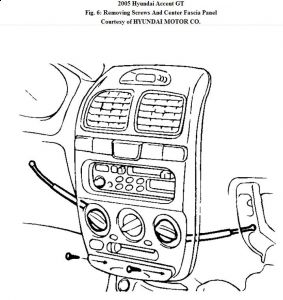

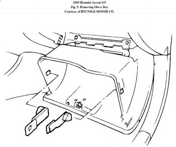

How do I replace the dash clock on my 2005 Hyundai Accent GT?

Hi esalas, You would have to remove the center fascia to be able to replace the clock. REMOVAL AND INSTALLATION 1 . Disconnect the negative battery terminal. 2 . Remove the glove box. 2 .
https://images.2carpros.com/forum/automotive_pictures/192750_HVAC05AccentFig05_1.jpg
3 . Disconnect the heater control cables under the glove box and lower crash pad. 4 . Loosen the screws and remove the center fascia panel.
https://images.2carpros.com/forum/automotive_pictures/192750_HVAC05AccentFig06_1.jpg

Thank you very much for your fast reply. Excelent pictures, too. Once the dash panel is off. How is the clock attached to the dashboard? Will i need any special tools to remove it?

It should either be clipped on or attached with Philips head screws and does not require any special tools.
Just remember to unplug the wire connectors so that you are able to remove the facia.
