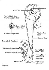

I AM HAVING TROUBLE SETTING THE TIMING BELT - I NEED TO KNOW HOW TO LINE IT UP

Hello and thanks for the donation!
Your vehicle's timing marks are below...if you need further assistance with this repair just let me know.
