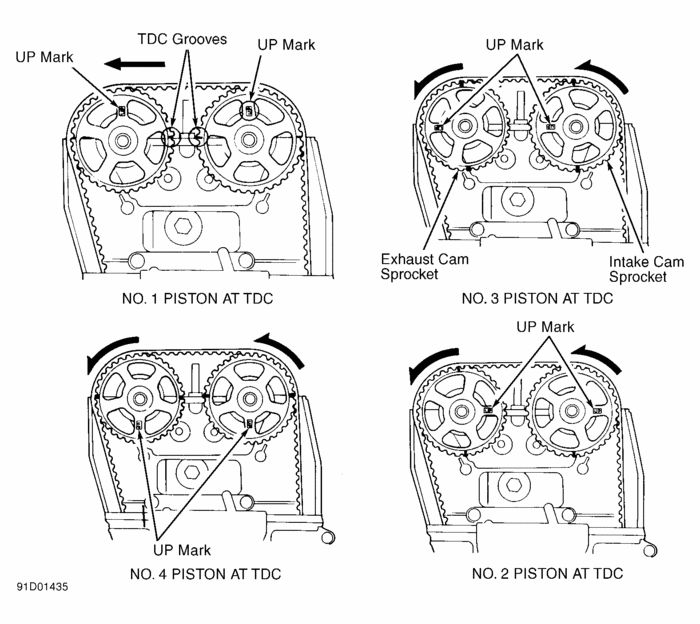

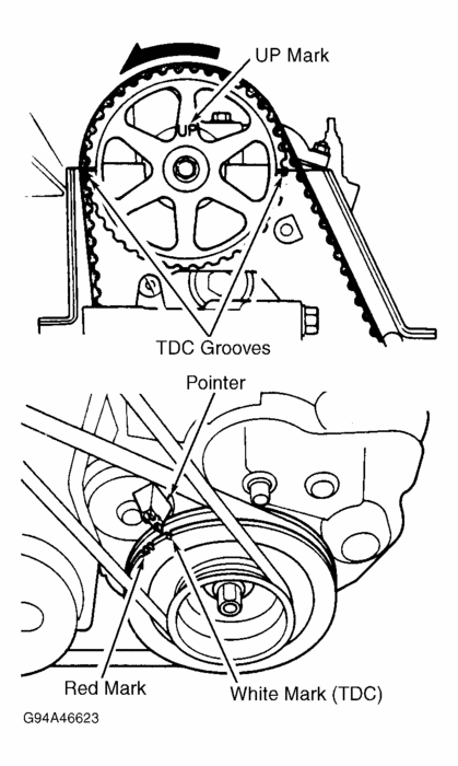

ICEMAN1506
i am replacing my timing belt and the crankshaft moved on me can you tell me how to reset the timing it is an sh motor with dual over head cams thanks.
Aug 8, 2020 at 10:47 AM (Merged)
BLUELIGHTNIN6
  • CAR REPAIR CONTRIBUTOR
  • 16,542 POSTS
https://images.2carpros.com/forum/automotive_pictures/261618_Graphic_676.jpg
https://images.2carpros.com/forum/automotive_pictures/261618_Graphic2_95.jpg

JOHN TERRY JR.
for reasons that i woun't go into now. i had to remove the timing belt covers and check to see if all the timing alignment points were lined up. they are lined up but there is slack in the balancer belt. the timing belt seems ok. what's the best way to remove the slack?
