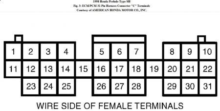

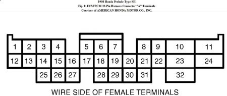

7 . Turn ignition off. Reconnect VTEC pressure switch connector. Start engine. With battery voltage connected to VTEC solenoid valve terminal, measure voltage between PCM 31 -pin connector "C" terminals C15 (Blue/Black wire) and PCM 32 -pin connector "A" terminal A10 (Black wire) or A23 (Black wire). See Fig. 1 and Fig. 3 . If about 12 volts exists at more than 5000 RPM, go to next step. If about 12 volts does not exist at more than 5000
RPM, replace VTEC pressure switch.
https://www.2carpros.com/forum/automotive_pictures/192750_ECM32Pin98PreludeFig01_1.jpg
https://www.2carpros.com/forum/automotive_pictures/192750_ECM32Pin98PreludeFig03_1.jpg

9 . Check for continuity in Green/Yellow wire between VTEC solenoid valve harness connector terminal and PCM 32 -pin connector "A" terminal A8. See Fig. 1 . If continuity exists, go to next step. If continuity does not exist, repair open in Green/Yellow wire between VTEC solenoid valve and PCM.
