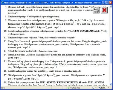

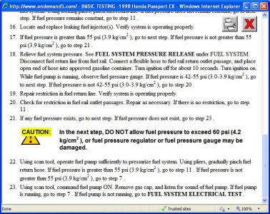

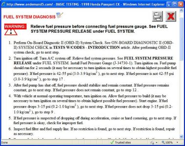

Aug 2, 2010 at 7:07 PM
SATURNTECH9
  • CAR REPAIR CONTRIBUTOR
  • 30,869 POSTS
https://images.2carpros.com/forum/automotive_pictures/416332_1998_honda_passport_fuel_pressure_test_1.jpg
https://images.2carpros.com/forum/automotive_pictures/416332_1998_honda_passport_fuel_pressure_test_part2_1.jpg
https://images.2carpros.com/forum/automotive_pictures/416332_1998_honda_passport_fuel_pressure_test_part3_1.jpg
Very strange the way 1 3 5 wasn't running then it was then it wasn't.Let's go with the fuel pressure it's on the low side and it shouldn't bleed down all the way in 5 sec's.So follow the trouble tree i posted i know you don't have a scan tool that can run the fuel pump so do the best you can with it.
