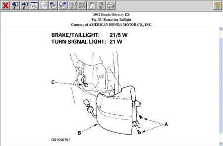

2002 Honda Odyssey 4 cyl Front Wheel Drive 65000 miles
Please Help with instuructions

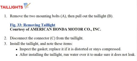

Hi dave36,
You need to remove the taillight assy to replace the bulbs.
