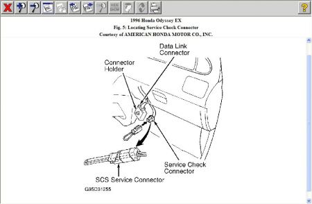

I need to no where the DTC plug is.
i found the 3 pin plug, but is there another one?

Hi portelli,
The 3 pin plug is the Data Link connector and is solely for use with a diagnostic scanner, DO NOT attempt to bridge it.
There is another 2 pin which you need to bridge to read the DTCs.
